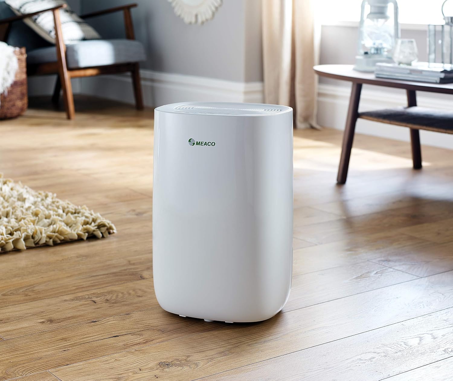

Em ngâm cứu thấy khá ưng Meaco, ví dụ con khác
https://www.amazon.co.uk/Meaco-MeacoDry-Dehumidifier-Ultra-Quiet-Efficient/dp/B07FKM4XWC/ref=pd_aw_sbs_79_2/257-1384623-8774633?_encoding=UTF8&pd_rd_i=B07FKM4XWC&pd_rd_r=d9d6849a-c6d7-4844-872f-97dcf2b973da&pd_rd_w=r4TC8&pd_rd_wg=XvlYR&pf_rd_p=0208d703-a674-4413-8899-c3889837d212&pf_rd_r=F7E59TEEQD5RZ8HAR0JE&psc=1&refRID=F7E59TEEQD5RZ8HAR0JE
Meaco MeacoDry Dehumidifier ABC Range 10LW (White) Ultra-Quiet, Energy Efficient, Laundry Mode, Auto-off, Auto De-Frost - Ideal for Damp and Condensation in the Home
4.8 out of 5 stars 250 ratings
thấy ghi Amazon's Choice for "low energy dehumidifier". Specs của Meaco như bên dưới
