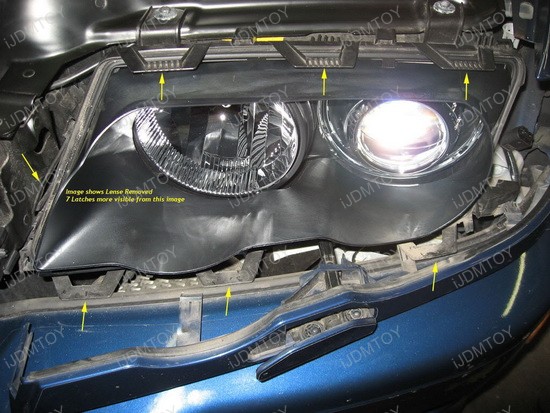

3) Lift up the five (5) tabs indicated by the arrows and pull the trim away from the headlight.
4) There are three (3) more tabs on the sides of the headlight. Release those as well. Remove the bottom piece away from the headlight.
5) Release the additional seven (7) that hold the lens assembly to the headlight as indicated with the yellow arrows. Remove the lens.
6) Release the seven (7) clips that hold the bezel to the headlight. Remove the bezel.

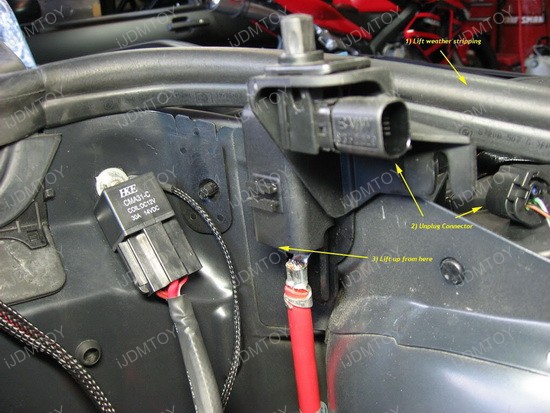

13) On the top of the engine compartment, there is an open area that contains the grounding and positive terminals of the vehicle. This is where you will mount the relay and majority of the wiring. The rubber grommet gives access to inside the cabin; the Yellow/Grey wire can be navigated through this into the cabin to your foot area light positive wire and have it tapped there.
14) Mount the relay to somewhere inside this compartment and connect the ground wire to one of the two grounding locations shown in the previous picture.
15) Connect the positive red wire to the positive terminal.
16) Route the wiring for the passenger side angel eyes along the chassis as it shows below.

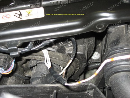

17) Route the wiring for the driver side angel eye over the top and to the other side as the picture shows. Move the Blue trigger wire towards the upper driver side engine compartment.

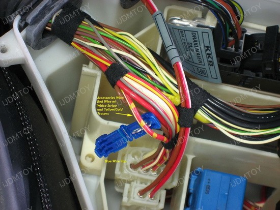

19) Tap the Blue wire from the relay to the Red with white stripe with yellow/gold stripes wire in the wiring loom.
*NOTE: Wire taps are not provided*
